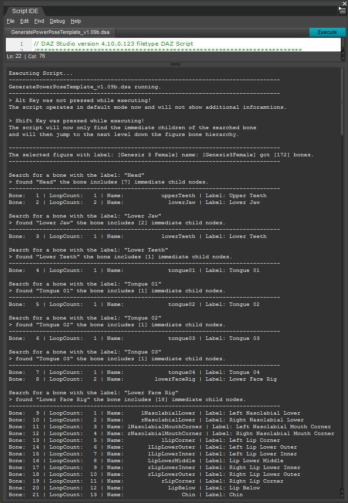

While the script iterates over the child bones you get the Script IDE console text blocks printed out, formatted in three different flavours: The default node listing now also includes node names.

OK now I figured out why generateTemplate("Head") was only finding the immediately children nodes because I was using getNodeChildren(false)all the time. This is the "Recurse" search switch parameter I was using for a flat hierarchy chain like with the Upper/Lower Face Rig bones but this was not what I wanted if I like to start with the "Head" bone. Now I have implemented both search methods to iterate over all children bones. By default the Recursive search method is used but you can also hold down the Shift key to use the other search method that I was using in v1.07a and v1.08a.

Screenshots of the console output:
GeneratePowerPoseTemplate_v1.09b_DefaultExecution.png GeneratePowerPoseTemplate_v1.09b_ShiftKeyExecution.png GeneratePowerPoseTemplate_v1.09b_ProcessFlow-LoopCountConfusion
