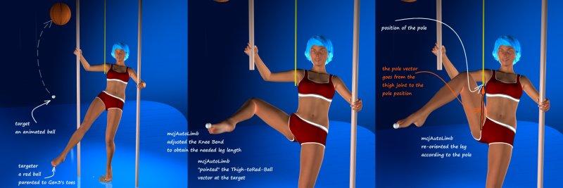

    the Pole vector is a bit hard to get used to, but needs to be understood, so make sure you read and re-read the instructions
    often, i un-parent the pole vector from the figure's collar bone or from the Buttock joint
    then i reposition it a bit, so that it's located where i want the elbow or knee to "point at"
    and i carefully delete any keyframes on that pole vector, to avoid bizarre leg/arm twist animations
    when you re-start the script, it looks for existing pole vectors and re-uses them instead of creating new ones
    if you have two genesis figures in the scene, then the script may use a left over pole vector from the other genesis
    so you probably should search for and delete old pole vectors in your scene before auto-limbing another figure

    good news !
    using 90% of understanding and 10% of guess ( it was not easy )
    i seem to be able to twist Genesis bi-jointed Thighs without having the targeter ( toe tip) ever leaving the target (red ball)
    with extreeeeeeeme precision
    and i'm probably able to do the other part of the target/targeter leg-aiming in 1 shot instead of 3 to 10 successive approximations
    so today thursday may be the release day for mcjAutoLimb2015 compatible with Genesis 3 ( and everyone else )
    800 x 600 - 748K
    Post edited by mCasual on

    good news the "pole vector" maths seems to werk perfectly
    so contrary to previous posts, this feature will remain as-is
    ... even if it's confusing
    ... because its usefull
    for instance twerking
    and duck-dance arm movements
    important stuff
    click on the attachment image for the larger version
    http://www.daz3d.com/forums/uploads/FileUpload/1b/3d2de4e7c9e872feb60bf4f140d6e8.jpg
    800 x 267 - 39K
    1920 x 640 - 147K
