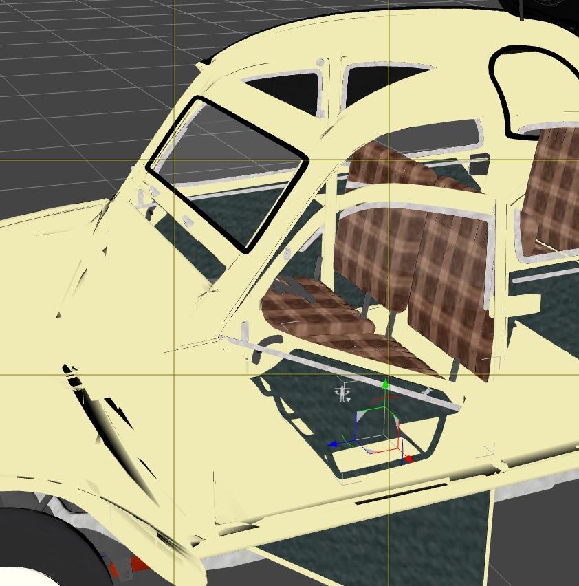

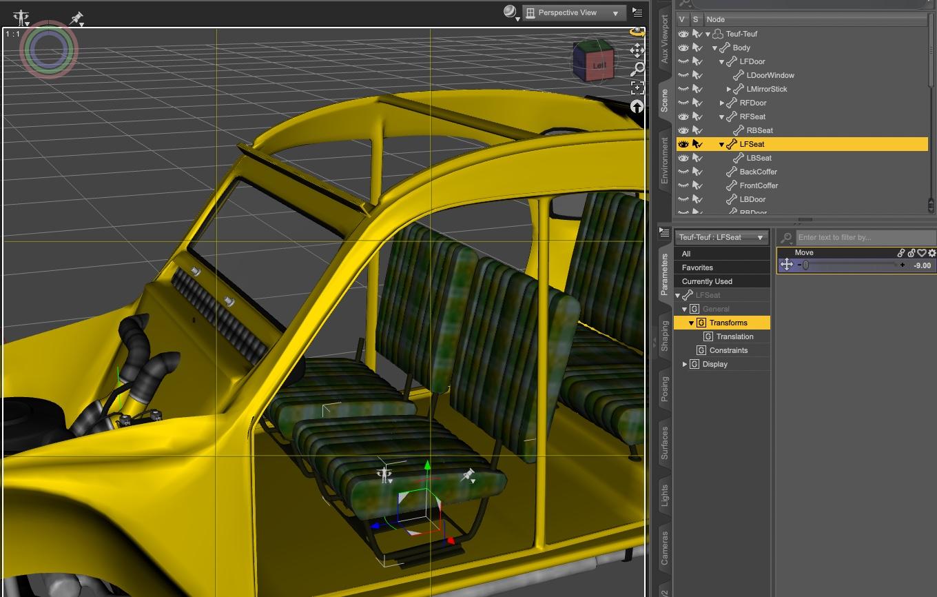

I was doing a tour of what was possible with it and when I tried to move the front seats, they initially moved as intended, but once I stopped clicking on the dial, the bottom of the seat I was moving went back to its origin. They both have the same problem:

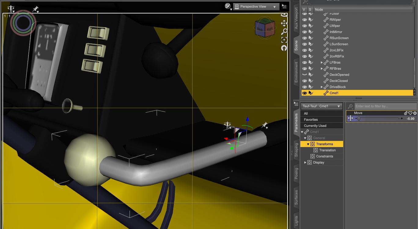

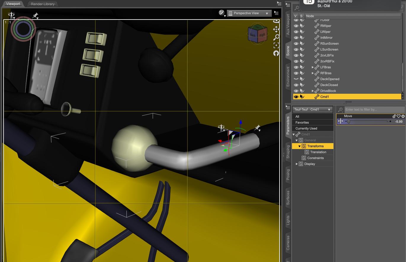

I think I checked all the other bones of the car and another one has the same reaction, the 'cmd1' bone (the gearbox maybe, I don't think I have been in a 2CV since I know how to drive). The first picture shows what happen while moving the cm1 thingie, the second shows what happen the moment I stop clicking.
I suppose there is a problem somewhere in the way the bones are set, but I have no idea where to look. If someone's has an idea, I'm all ears

For the seats, the weight map for the Body node includes the LFSeat and RFSeat (including the frame underneath), which prevents the seats from staying in position, because the seats' own weight map is still in play. That's why they can move with the control, but snap back when you let go.
So, start by selecting the Body node in the Scene tab. With the Weight Brush tool go to Tool Settings->General. Under Weight Maps, select X Rotation, and you will see that most of the vehicle, including the seat bottoms and the supporting frames, are bright red with weight (the seat backs are not). Using the Geometry Selection Mode in Tool Settings, select a polygon on each seat bottom and one polygon on on each seat frame (with the Body node selected, not the seats) then hit Select Connected (CTRL * or right-click in the viewport and Geometry Selection->Select Connected). The whole seat bottom and support frames should now be completely selected. Right-click in the viewport and go to Weight Editing-> Fill Selected. In the dialog, dial the amount down to zero and Accept. Back in Tool Settings, repeat for the Y and Z Rotation maps in turn, and set their weights to zero like the X Rotation. (The Scale weights appear to be okay). The seats have their own weight maps, so now your seats will stay in place when moved.
For the CMD1 lever, do the same sort of thing for the silver parts of the lever (the handle itself) but not the black sleeve where it goes into the console which is all part of the same mesh (Select Connected will select too much). The X, Y and Z Rotation weights must be removed from the Body Node for the Cmd1 handle polygons (again, with the Body Node selected). The Cmd1 node has its own weight maps that will function properly after the correction.
