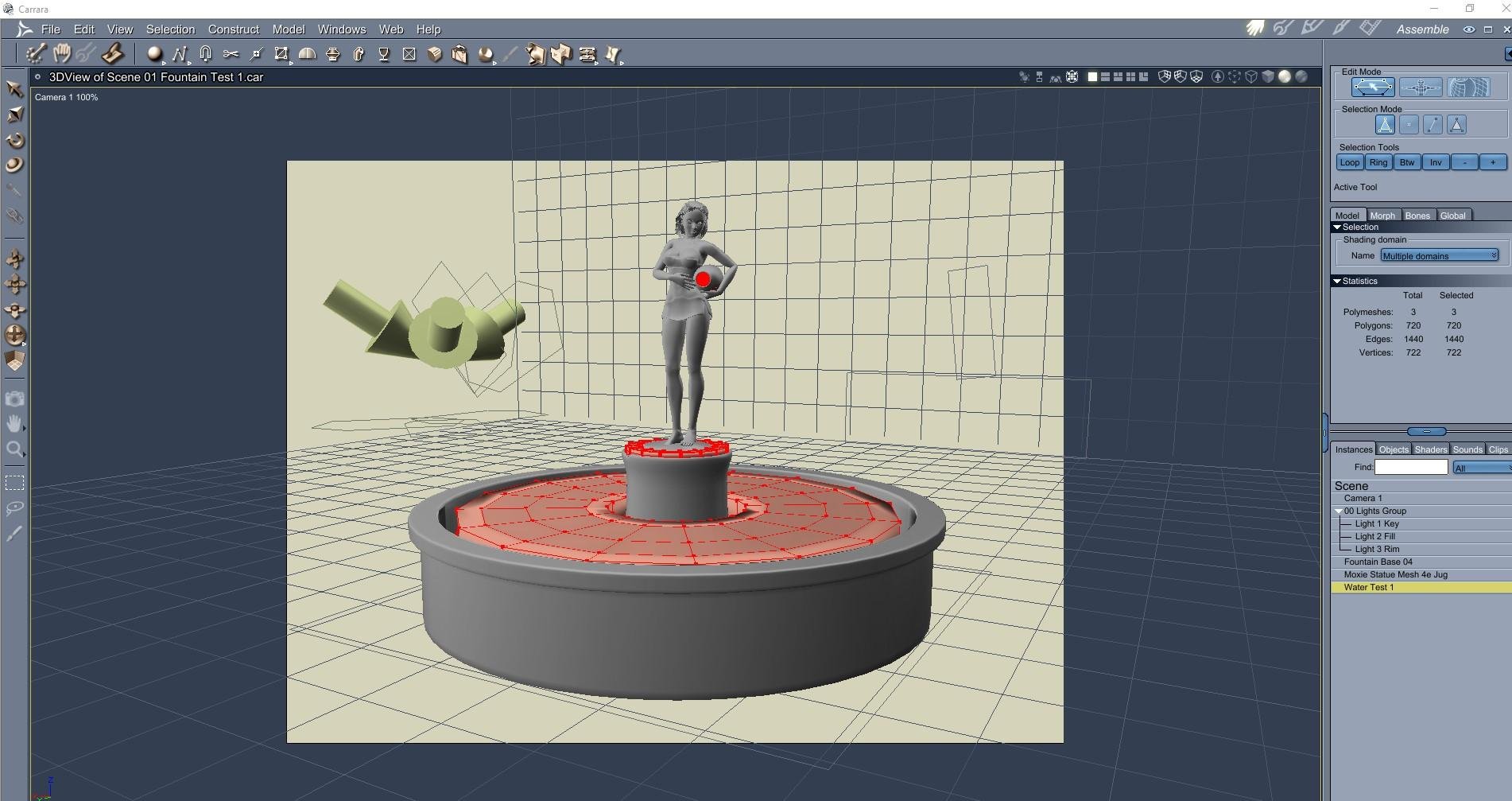

  • Alberto!
    You did it again!!! What a beautiful update to an already impressive plug-in for Carrara 8.5. Saying "Thanks!" just doesn't seem quite adequate - I simply had to come out of retirement to give it a go and the mesh smoothing factor is such a welcomed asset - I LOVE IT!!!!!
    Below are six frames taken from a short animation of two separate liquids with different viscosity settings, which I believe highlight the truly amazing meshes that Fluidos II produces.
    To get the upper-most liquids to interact with the lower one relies on the first liquid being animated first (FD1) then the resultant meshes used as a liquid in the second simulation (FD1-Result). I don't know if it's possible to 'nest' fluid domains and have the liquids (with different viscosities) interact real-time? That would be amazing!
    Attached is a screen shot of the scene setup...
    258 x 707 - 45K

    Doing Something Wrong - Please help.
    I'm not getting a simulation over multiple frames, just a static end result (which has a leak).  I made a vertex object composed of three meshes.  There are water meshes for the base of the fountain, the mid ledge around the statue feet, and a sphere inside the jug.  I created a Fluidos domain and parented the water object, the fountain, and the statue.  I used the effects tab to designate the water object as fluid and the fountain and statue as solid. I didn't see a FluidosS option under the menu for the second domain so I chose Fluid Viewer.  I turn off visibility of the original water object.  When I render the simulation, no movement, just what looks like a completed simulaiton.
    I am attaching screenshots of each step.  The screenshots are numbered.  The name of the screenshot file describes what I was doing at that step.
    Start - the water object is red.  Setup intended to result in water spilling out of jug and water sloshing in the base and by the feet.
    Setup

  • DiomedeDiomede Posts: 15,194
    edited April 2020
    Still not getting a multiframe simulation
    BUT - I have discovered problem #1 - my fountain and statue are not closed objects.  The jug is.  Will fix solids and try again.
    Post edited by Diomede on
