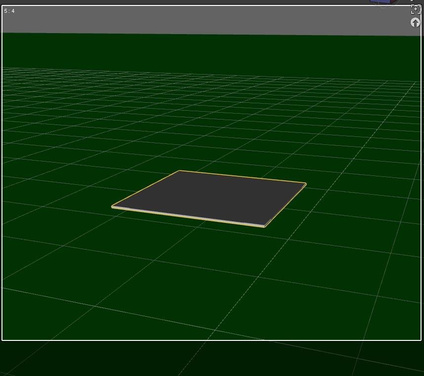

1. New scene.
2. Create Primitive Cube. Size: 1M, Divisions: 20.
3. Increase the cube's YTranslate to 100, lifting it off the ground.
4. Reduce the cube's Y Scale to 1% to appear like a sheet.
5. Edit > Object > Geometry > Add Dforce: Dynamic Surface.
6. Create Primitive Plane.Size: 200M, Divisions: 50.
7. Change Plane's Diffuse to Green for contrast.
8. Checked Simulation settings and Surface settings. Made sure all of them were default.
9. Ran Simulate. Cube goes upwards, away from Plane.
I then did these steps, which worked the last time:
10. Cleared Simulation.
12. Added Primitive Sphere.Diameter: 1M, Segments: 100, Sides: 100.
13. Changed Sphere Diffuse to Red for contrast.
14. Reduced the sphere's Y Translate to -75 so that it is peeking through the plane.
15. Ran simulation.
At this point, during my last experiments, the cube dropped to the plane. This time it is still going upwards. So I am experimenting to see what I can change to get the right behavior to occur.
Adding that I cut the simulation early, after only a few seconds, for that screen capture. If I let it run any further, then the cube shoots off into the stratosphere.

I am guessing that the primitive sphere in Daz Studio is a geometrically defined object (ie, it is defined by a centre point and a radius) and therefore does not have vertices and polygons as such. And as that is what dForce needs to be able to calcaulte the interactions, that is why it is ignoring the sphere and not the other objects.
Your plane isn't terally as plane - its edges have cery dense geometry, each loop separated by 0.5mm. I suspect its the interaction of those tightly packed loops that is driving the odd behaviour.
The original "sheet" I was using was a smooshed Cube. The vertical faces of that cube still has as much geometry as the flat horizontal faces (the top and bottom.of the "sheet"). All that geometry is smashed into a tiny area causing the calculations to go haywire.
I can sort of confirm this as I tried the "sheet" using a plane. That descended properly and draped as expected.
I also was able to get the sphere to interact properly by increasing the sides to it. I would have thought that 100 sides would be sufficient, but apparently not.

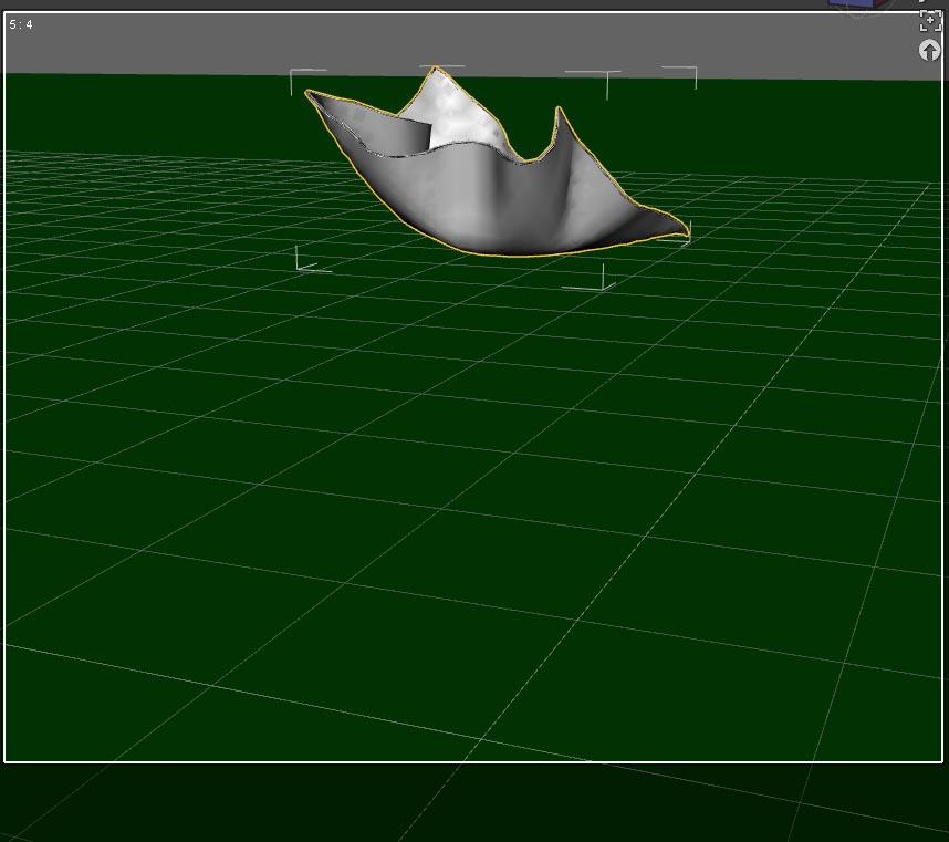

All my experiments and images might seem like crazy, irrelevent nonsense, so I thought I would show what I was trying to do...
This is a TerraDome 3 landscape with a narrow plane draped dynamically down it. It's a very crude example of where I was experimenting; in this case to create a waterfall... But equally useful for creating paths or tree lines, etc.

1. New scene.
15. Ran simulation.
The sphere actually does have a mesh, but it's incredibly uneven and I find that can do weird things with dynamic stuff.
I've found it useful to make retopo spheres with more even meshes for draping and other purposes.
I think I get what you're all referring to...
